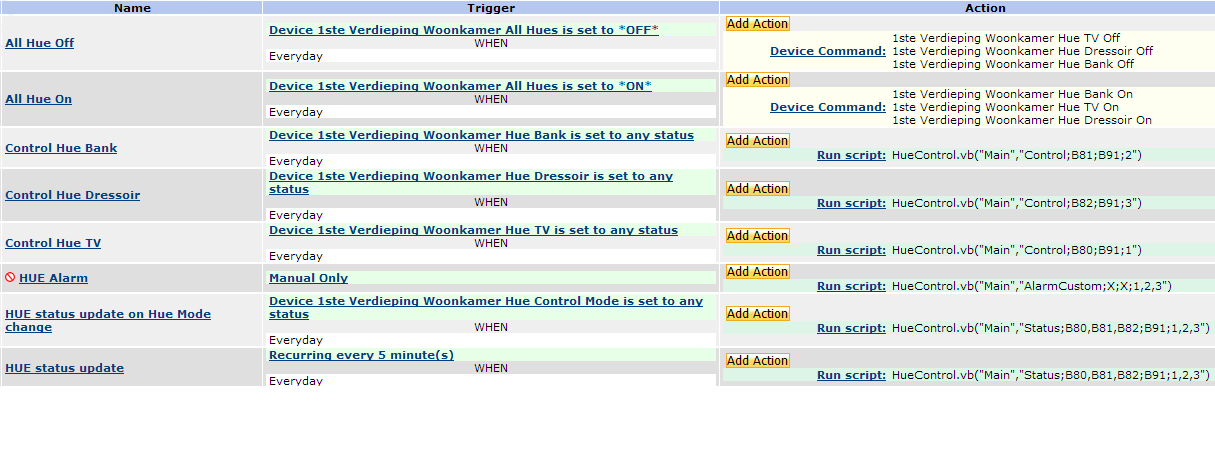

Example how to configure the events;
How to configure the events
event config.png (50.25 KiB) Viewed 46638 times

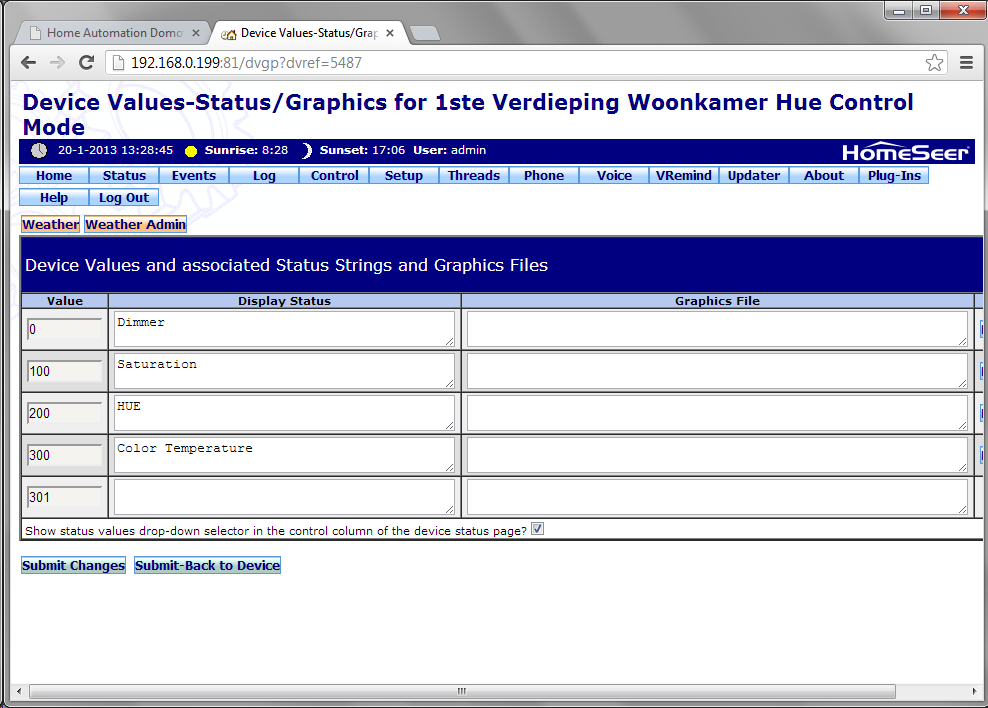

Configuration of the Hue Mode Device;
How to Configure the Hue Mode Device
Mode device config.png (77.45 KiB) Viewed 46638 times

''3 - Create one or more Hue Mode devices as virtual device with 4 Value Pairs;
'		0=Dimming
'		100=Hue
'		200-Saturation
'		300=colortemp
' 4 - Make an event for status change for every hue homeseer device and select this script to execute.
' For the parameter field use ("Main","Control;B80;B90;1")
' 5 - Make a recurring event to trigger status update of Hues in Homeseer with this parameter field, ("Main","Status;B80,B81,B82;B90;1,2,3")
' 6 - also possible to trigger Alarm by ("Main","Alarm;X;X;1,2,3") or ("Main","CustomAlarm;X;X;1,2,3") this causes the hues to flash.

'USAGE with HomeSeer
' 1 - Fill in HASH and Bridge IP into this script
' 2 - Create Homeseer Lamp Devices for every Hue in your system
'		0=Dimming
'		100=Hue
'		200-Saturation
'		300=colortemp
' 5 - Make a recurring event to trigger status update of Hues in Homeseer with this parameter field, ("Main","Status;B80,B81,B82;B90;1,2,3") I also use a status update on device value change
' 6 - trigger Alarm by ("Main","Alarm;X;X;1,2,3") or ("Main","CustomAlarm;X;X;1,2,3") this causes the hues to flash red.
' 7 - Colorloop mode; enable by ("Main","ColorfadeStart;X;X;1,2,3") disable by ("Main","ColorfadeStop;X;X;1,2,3")
' 8 - WakeupLight; enable by ("Main","Wakeup;X;X;4") causes fade in from off to full brightness in 4 min, time can be changed in script.
'Script parameters: ("Main","<executionmode (control or status)>;<DeviceCode Homeseer Control Device>;<DeviceCode mode Device>;<Hue Number to control> ")

im a little lost on the final setup, can you explain and maybe show actual example of how i set the colors and brightness, i must be doing something wrong as im getting errors.
i set up the 3 hue lights and called them L1 , L2 and L3 i created the devices as lamp modules
i then set up 1 virtual device V9 named it Hue Mode and added the optional device values
when sending the command say to turn lamp 1 on to blue , how exactly do i do it

ok i figured the basics out , a few questions: is there a quick easy way to select a particular color for i can add color buttons to hs touch?
also can i co a color wheel type thing on tstouch to dial a color up?
bartbakels
Posts: 515
Re: Philips Hue Control Script
Post by bartbakels »
hi,
You can use events to do this, by sending a http command to the bridge. Once i have some time I will create this also in the script.
(ON ESXI )on NUC
