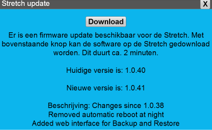

Posts: 48
Re: Console access on Stretch
Post by Phoenix »
Ok, i got some firmwares as Linux BIN/IMG files, the Linux headers are inside, so this is the first step! :D
Does anyone know more firmware versions?, i got:
Smile:
1.2.8 (released 2013)
1.1.9 (as released late 2012)
15.3.7 (old version, no GUI interface?)
15.3.11 (old version, no GUI interface?)
15.3.12 (old version, no GUI interface?)
As with the trick to get firmwares for the Smile the same can be done for the Stretch by adjusting some variables :mrgreen:
Stretch
1.0.38 (?)
1.0.40 (released 2013?)
1.0.41 (released 2013)
Desktop software message:
stretch update.png (21.7 KiB) Viewed 23631 times

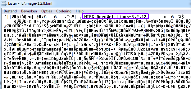

Capturing and copying:
The Linux header is inside, this is a example from the Smile firmware (Stretch = Linux v3.3.7)
smile update check 05.png (29.35 KiB) Viewed 23631 times
