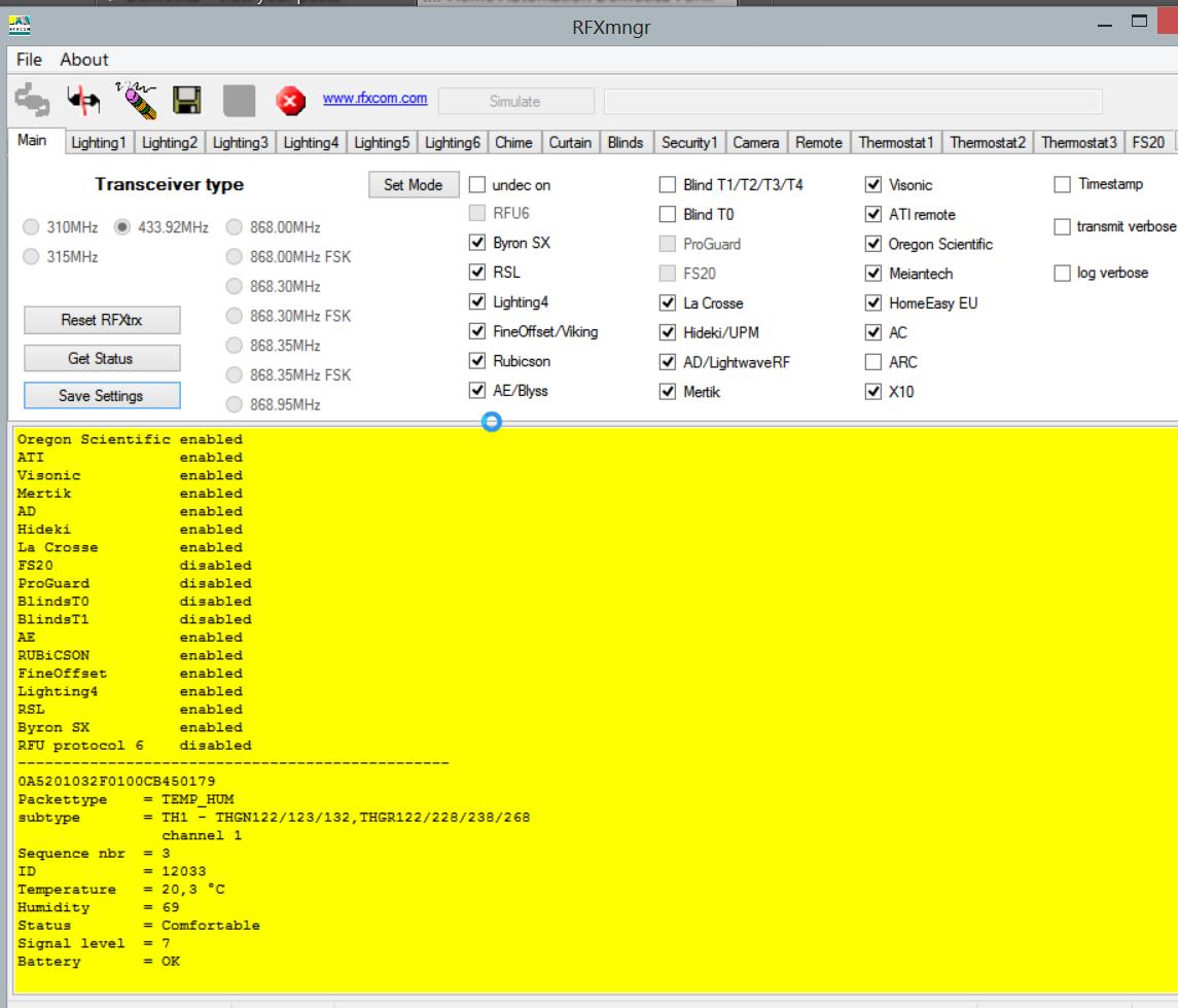

Re: RFXtrx433 firmware update 67 / 68
I have a firmware update.
Only my protocolls are not enabled.
What i try, the are not to enable
Everytime i will save them they are not going on, the marker is away when i save them.
And then the ui give dissabled.
help me please...

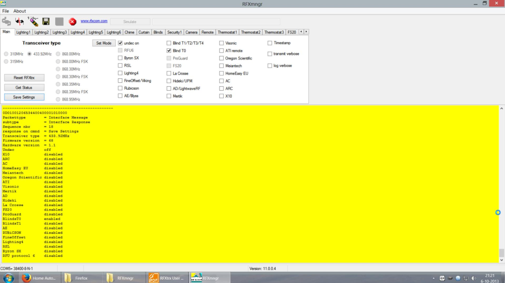

BlindT0 will disable all other protocols!!!
Do not select BlindsT0 unles you want to receive the Rollertrol remote to know the remote ID. In all other cases select only the protocols in use.
See chapter 2.4 http://www.rfxcom.com/Documents/RFXtrx% ... 0Guide.pdf
And do not select undec on unless requested by RFXCOM.

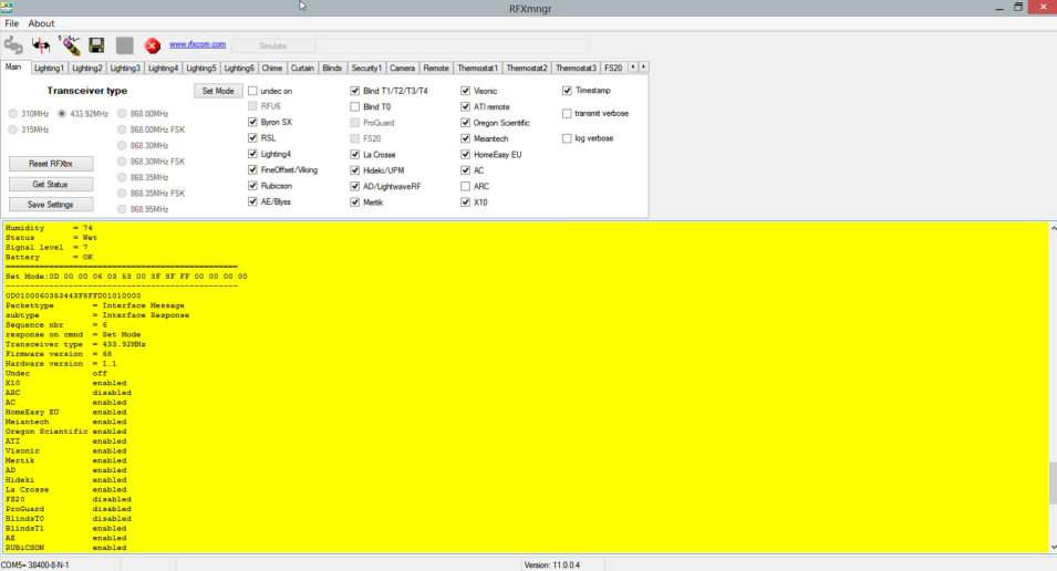

A match better...thanks
Only ARC is going of everytime, is that a problem? [ i think yes, this is the protocoll for NEW KaKu, and that is my most used one.. ]
Bud now i have the most protocolls marked
Ps what is the differends between,Type 1 and type 2 ?.
Please please RT.M : RFXtrx User Guide!!
See chapter 2.2 for the differences between Type 1 and Type 2
This chapter gives you also the information which protocol to enable for a certain protocol.
You cannot enable all protocols because some will inhibit other protocols or at least reduce the receiver sensitivity for another protocol.
Chapter 2.4 says:
The sensitivity of the receiver part is highly influenced by the number of protocols enabled.
Lesser protocols enabled will make the receiver more sensitive for the enabled protocols.
So for example if you do not have Meiantech sensors do not check this protocol, if you only have old KAKU, check only ARC.
The protocol enabling is only for receive, the transmit protocols are always enabled.
Chapter 2.4 says:
