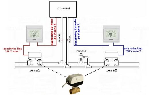

Option 5: Create multiple physical zones
Go from 1 physical zone to multiple ones. So you can have multiple Wall Thermostats which independently from each other can inform the Boiler/Furnace to turn on or off. This means that if Zone 2 Wall Thermostat tells the Furnace to turn on, all the rooms + the piping structure in Zone 1 are not being heated. That should be more heat efficient. See the pictures below for more information. (source: http://www.heatnet.nl/zoneregeling.html).
For each 'Zone Wall Thermostat' = 1 zone, you can then also apply (I think) options 2, 3 or 4.
