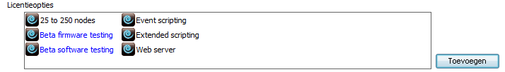

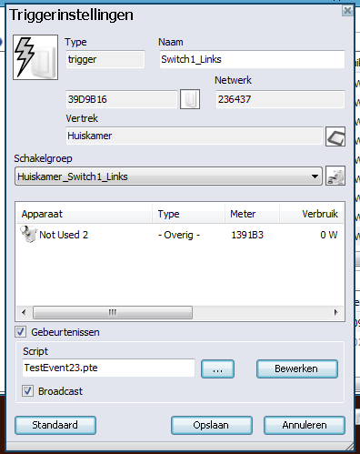

I added the events license to my Plugwise Source program (50 euro :-(). This enables me to run a script directly at the push of a Switch button, Scan movement, Sense changes or any other Source event.
This script can execute any external program or other scripting command you might find useful. Using an external program enables me to run a Homeseer event or command, but of course you can also interface with any other program....
See screenshots.... Maybe this is useful for anybody.
