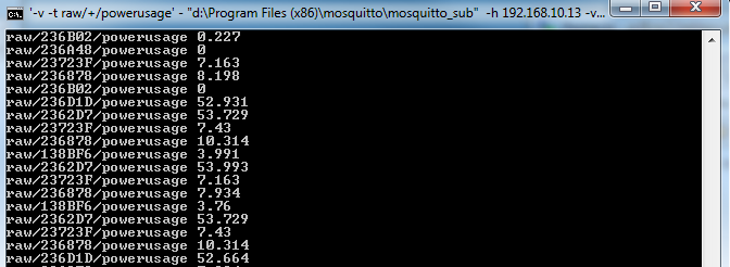

To make it even more clear of what you get:
Being able to display it in a console means you can do anything with it 8)

Would you like to share your 150 lines of code 'for inspiration' also? I'm not a JS programmer but looking at your output, it converts Plugwise data to MQTT topcis, just what I need to get a heads start.
