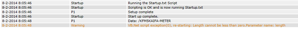

When starting Homeseer the following messages apear in the log file (see attached screen dump)
To me it looks like the script is running and the first line of the data comes in. The next line however is an empty line. Looks like this where the script generates the error.
Is this assumption correct and how can I resolve this?

I tried an nearly empty script with just a few lines to write the data that has been read to the log file of Homeseer. The results is exactly the same. Only the first line of the data arrives followed by the warning message.

The script seems to error on the second line of data received. This line holds just and CRLF. How can I modify the script to stop the error from halting the script?
