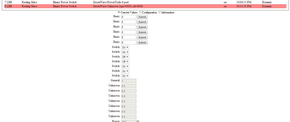

I bought two powernodes (6 ports) Nuon aka Greenwave.
They have different firmware versions and the settings are different as well in openzwave control panel (see attached photo).
The problem I have is that I can't reset the values like the other powernode and also a lot of unknowns are there
Is there a way to put a new firmware on there?

Re: GreenWave Unknown (powernode)
I understand but why do I have no totals with node8 while I have them with node7.
Also I have different Library/ Protocol and Application versions between node7 and node8
Also I can not read the configuration out of node8.
I will reset the device maybe that will help
Hoi,
Heb het al opgelost
Aan de hand van http://www.domotiga.nl/projects/domotig ... _OpenZWave (Unknown device in Z-Wave Commander):
<Manufacturer id="0099" name="GreenWave">
<Product type="0002" id="0002" name="PowerNode 1 port" config="greenwave/powernode1.xml"/>
<Product type="0003" id="0004" name="PowerNode 6 port" config="greenwave/powernode6.xml"/>
</Manufacturer>
is nu:
<Product type="0003" id="0006" name="PowerNode 6 port" config="greenwave/powernode6.xml"/>
</Manufacturer>
Heb het al opgelost
</Manufacturer>
is nu:
</Manufacturer>
