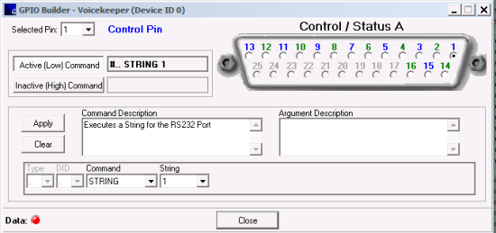

On the back of the unit there are two DB25 connectors that are used for I/O. Look in the manual for more info about these connectors.
Eight of these pins give the state back of the gate however they behave like momentary switches. They are on for a short time and then off again. You can connect an Arduino (or any other board) to these pins and handle the I/O from there. The Arduino can then push back the info to your system where you handle it further.
Tip #4

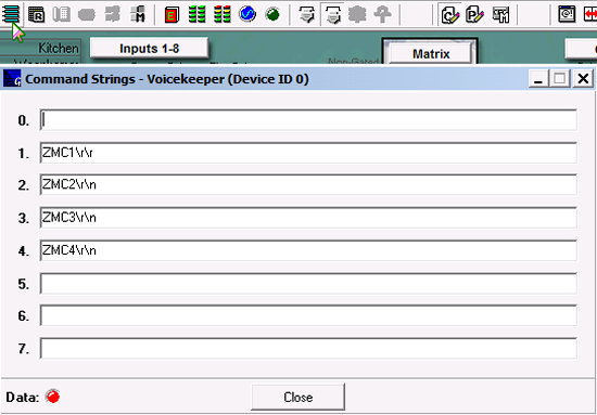

I figured out this solution which is more elegant. It uses the same DB25 connector on the back mentioned at tip #3.
You can wire the gate output pin directly to a free input pin on the same connector. You can stick a piece of wire into them or get a DB25 male connecter and solder the wires there and plug in the connector afterward (best solution). For gate 1 you connect it to pin 17 directly to pin 1 on connector A. Pin 1 is a control pin and its behavior can be programmed. Next you open your software for the unit (G-Ware for the XAP800) and go to the GPIO builder.<br>
Configure pin 1 that it will send a string to the RS232 port. This will actively push the gate info into your system. (Btw, the ZMC script handles this for you). You can also configure the text that will be sending back with the command string editor but there I no real need for that.[/i]

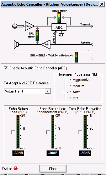

The unit has another cool feature and that is that it is capable of canceling out noise sources. It will do so by subtracting one audio source from another. This concept may be strange but if you have a look here it may become clearer. http://en.wikipedia.org/wiki/Active_noise_control
Your microphone will not only pickup your voice but also the music in the background.
If you followed the setup this far you have your voice and your music in two separate channels in the unit. What you want is to subtract all the other sound channels that might be playing in the same room as the where the microphone is from the signal coming from the microphone. If you do so you will keep a clear signal with only your voice in it and nothing else. Even the loud music at the background will be gone. If you are using an AP800 you do this by sending all other audio to one output (an output that doesn't go anywhere) and use that output as reference. When you have a XAP800 thing are simpler. You can setup a virtual reference without losing an output. I only use one channel to block out the music. This shows the strength of this setup by using a processor in between. This virtual reference is connected to the AEC setting found under the microphone input settings.
