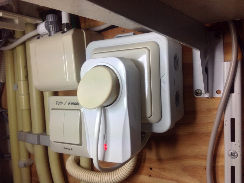

In the kitchen there is a High/Low switch to set the speed manually. The two wires from this switch are extended in parrallel to a place where a standard KaKu unit is installed.
The KaKu unit controls a small relay connected to the two wires. The relay is installed in a standard gray installation box from Gamma. A 220v standard mains socket is installed in the cover; the KaKu unit is put into the socket. Of course you need to supply 220 volts for the mains socket to the gray box, otherwise the KaKu is not working.
Then at the location of the Eco fan, I installed another gray installion box (I bought 2 at Gamma ;-) ).
In this box is again a small relay installed that is controlled with the h/l switch or the KaKu (they are in parrallel remember). The relay contacts are controlling the speed of the Eco fan. The nc contact for low speed and the no contact for high speed.
The 2 relays are the same: 220V/5A from Conrad (http://www.conrad.nl/ce/nl/product/5033 ... archDetail).
You can buy a complete set with mounted relay on a pcb and a kind of universal mounting kit consisting of two sides that click together to form a housing. But warn you, Conrad site is a mess around this product. But its cheap ;-)

Hi DJ, that is quite some time ago!
I used a KaKu with the formfactor of an ACM1000, but one of the cheaper series.
Because I did not build it into the eco fan size did not matter.
Inside the gray box is a 220 volt socket and squeezed the releais pcb to the side that holds the contacts in parallel to the fan switch in the kitchen.
Regards
