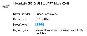

Isn't there something about the newest driver not being the right driver for Aeon stick?
This is the one I use. I don't have disconnects.
