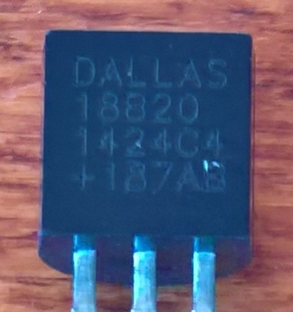

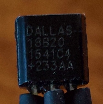

Ok, to answer an old post of myself; I found out that not all DS18B20 are the same. I hade two batches, both didn't work. I recently got another batch, and they all do work...
So, for anyone interested:
Does NOT work:
Does NOT work:
Does work:

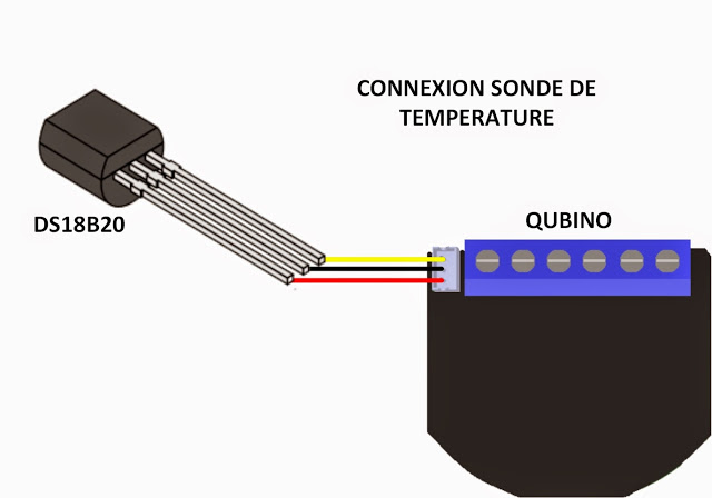

And this is how it should be connected:
