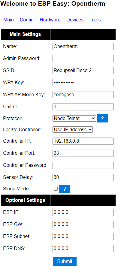

I have both NodeMCU and OTGW working seperately, but cannot connect the OTGW to NodeMCU. I used several combinations.
The NodeMCU has connected to Wifi, that works. It has an IP address

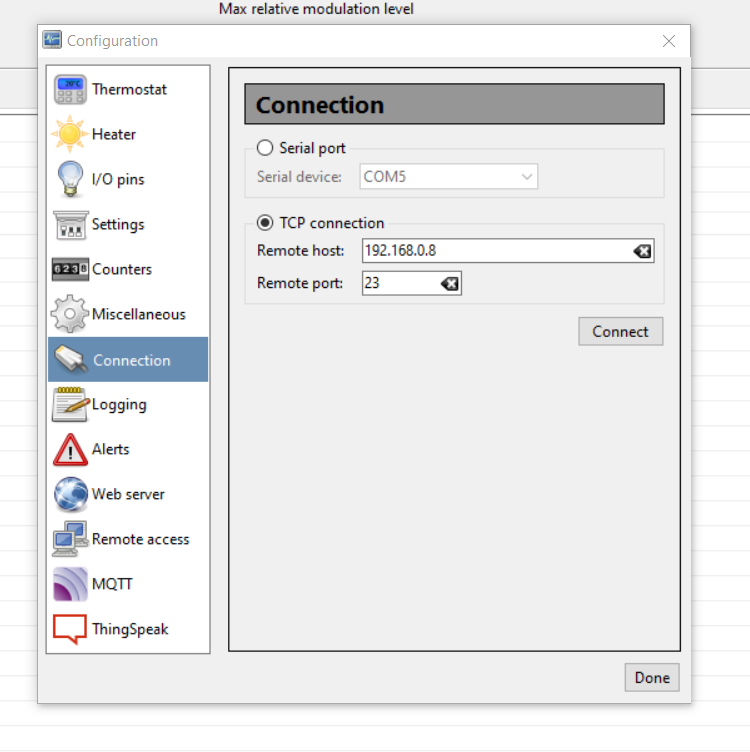

I can OT Monitor connect to OTGW through the COM port, that works.
But when I plug the NodeMCU on the OTW board and want to connect through OT monitor to the OTGW with wifi, I cannot get a connection.
What Remote Host address and Remote Port do I have to use? How can I can configure this?
Screenshot settings Nodemcu:
OT monitor screenshot.png (113.34 KiB) Viewed 3392 times
NodeMCU screenshot.png (37.08 KiB) Viewed 3392 times

The ESP easy firmware is general purpose firmware. As a result it has lots of settings you have to get right to work correctly with the OTGW. This is why the OpenTherm Gateway Manual provided by the Nodo Shop suggests to use firmware that was created specifically for the OTGW: If you insist on using the ESP easy firmware, I think you selected the wrong setting for "Protocol". According to my notes, it should be "- Standalone -" if you're not using Domoticz.

I overlooked a part of the v7 manual about the easy esp settings in the wifi module. I entered the values that were mentioned in the manual and that worked.
