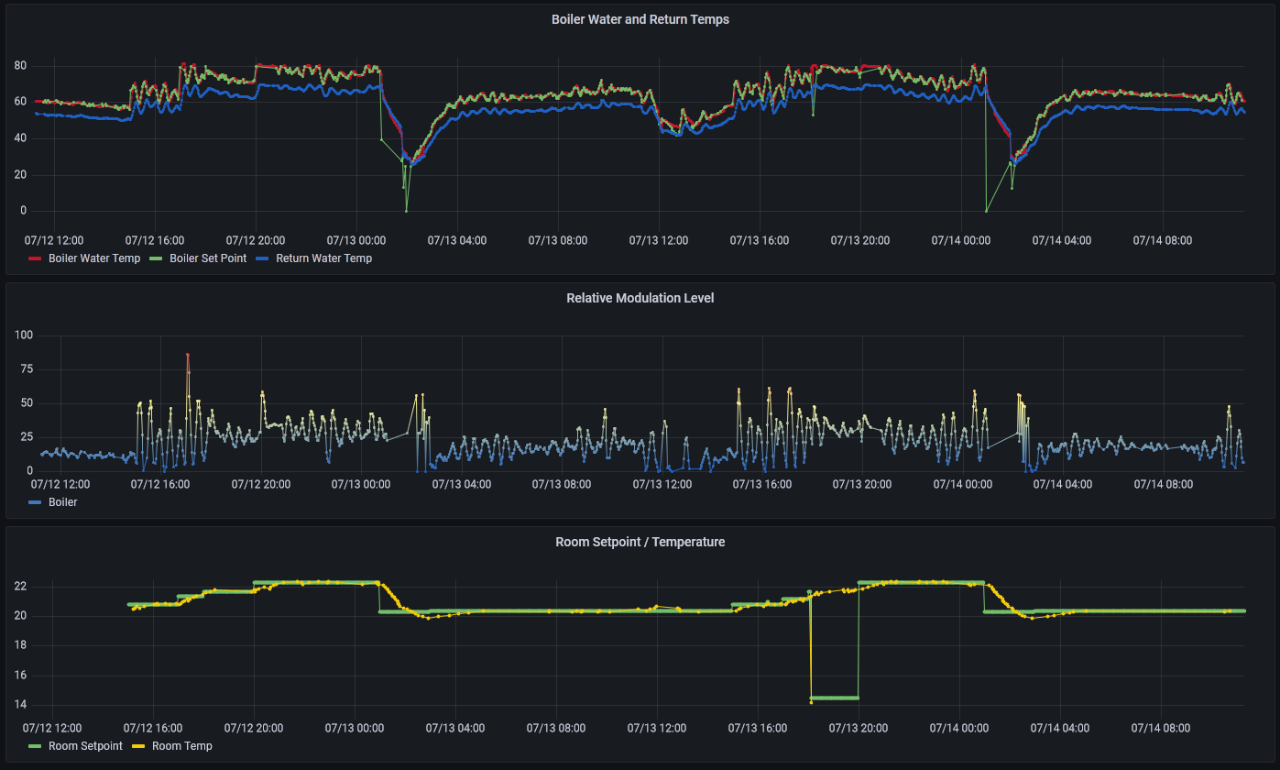

I love data, I wanted to see what the Tado was doing, and actually wanted to see how the boiler and system was performing, specifically trying to dial in return temps for efficiency. So far its providing a great level of detail - so thanks for everything you do :)
It integrates well with Home Assistant as well:
otgw demo.PNG (277.69 KiB) Viewed 2989 times
