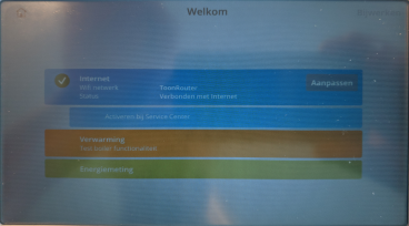

I'm trying to activate a factory resetted Toon by using the router script procedure. I can connect the Toon to the ToonRouter network, but the setup wizard doesn't provide an activation button afterwards. Instead, the following screen is shown:
I tried tapping the "Activeren bij Service Center" bar itself, but nothing seems to be working.
Does anybody know what's going wrong here? Thanks for any help in advance!

The activate button only appears if the toon has a valid connection to the internet AND it can connect over the Toon VPN to the toon servers. That last thing could not be working if the toon isn't having valid VPN certificates (which a lot of 2nd hands toons have now). Only way to root these toons are using the hardware method.

Indeed. Stop trying and use the hardware method. All toons showing this screen for more than 10 minutes have a vpn failure. Only hardware rooting is possible.
