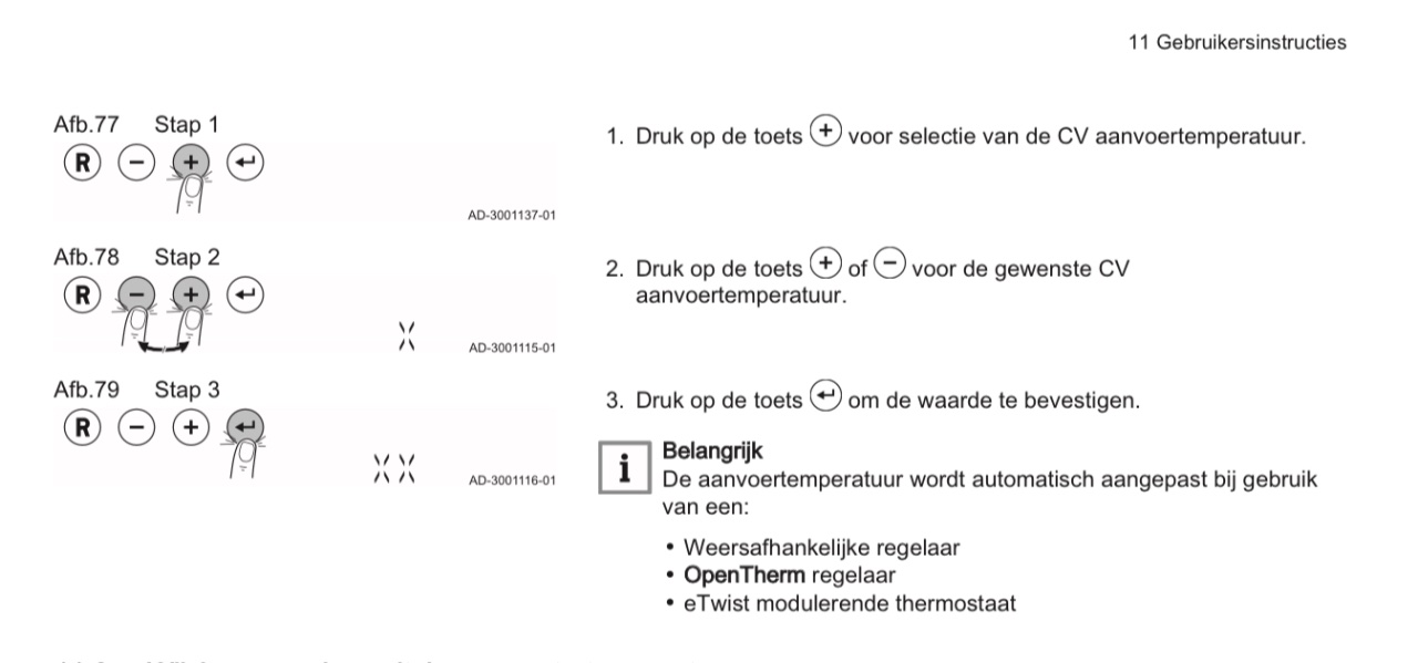

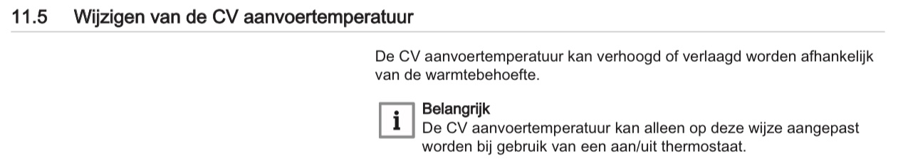

I managed to increase SH to above 50.
It turned out its not (just) setting the code CP000 to 80 on the Remeha Tzerra Ace, but rather (or also?) the max temp value before you even go into the menu of the boiler.
See below: In case anyone has the same issue in the future, I’ve added the part where it’s described in the manual:
The manual states that when using Opentherm (and in my case weersafhankelijk), it should be adjusted automatically, which In my case it didn’t.
Anyway, problem solved :P

An opentherm controller can adjust the max temperature setting, but only within the advertised bounds. So the boiler should provide the correct bounds in MsgID 49. Have you checked that they were still wrong before you made the change on the boiler? And did changing the temperature on the boiler make any difference in the values reported in MsgID 49?
Bartb
Posts: 6
Joined: Mon Nov 07, 2022 6:38 pm
Re: Boiler water temp higher than maximum?
Post by Bartb »
Interesting indeed.
Yes, the boundaries were still 50 to 0 before I changed the setting on the boiler.
After I set the boiler to 80, I didnt check the string of values itself (PS=1), but I did send a PS=0 command straight after which then resulted in updated boundary values "80 0" in the "statistics" tab in OTMonitor app. I guess this tells that it worked. To confirm the correct working, I then set SH=75 which was then confirmed with a SH=75 response (msgid 57).
