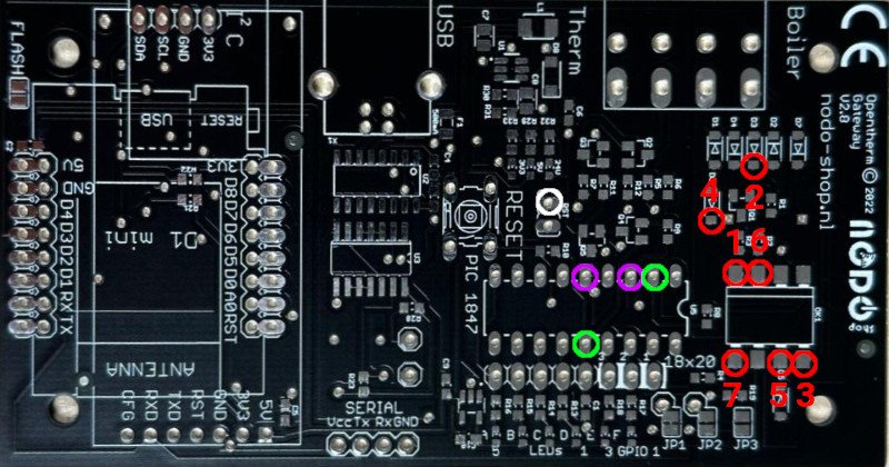

That sounds like there is something wrong with the boiler interface of your OTGW. To diagnose, remove the PIC from its socket, make a loop between the thermostat and boiler connectors, apply power to the OTGW, and measure the voltages on points 1 through 7 indicated on the picture below (it's a picture of v2.8, but the components of the boiler interface stayed in pretty much the same position ever since before version v1). You can use the pin indicated by the white circle as your reference point (GND). Any other point connected to GND is also fine.
Next, make a connection between the purple circles (pin 3 and 5 of the PIC socket, in case you're colorblind) and measure all 7 points again. Finally, remove the purple connection and make the green connection (pin 2 and 14 of the PIC socket) and measure the points again.
The expected results are:
Test 1:
  • 0.7V
  • 16.5V
  • 15.8V
  • 1.9V
  • 0.5V
  • 1.0V
  • 0.0V
Test 2:
  • 0.7V
  • 16.5V
  • 16.0V
  • 5.3V
  • 1.0V
  • 1.9V
  • 2.5V
Test 3:
  • 0.7V
  • 5.4V
  • 4.8V
  • 2.0V
  • 4.6V
  • 1.1V
  • 0.0V
The values may differ a bit, but those are roughly the voltages you should find. Any big deviations you find will hopefully point to a bad connection, or damaged component.

I see big differences in the bold part (the biggest difference in tests 1+2). And some smaller (but I guess relevant) differences in other measurements.
I checked the schematics and see these measurements are linked to the optocoupler pins. And due to the loop between X1/X2 there should be the higher voltages you specify I guess.

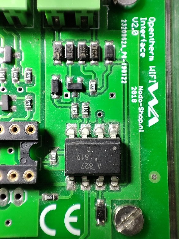

Photo of the boiler part of the print

I checked th bottom of the print and see bad soldering
Bad soldering
Bad soldering
I am going to solder this and test again
