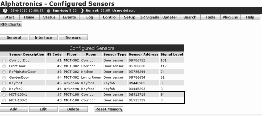

The MCT-100 is ON at the moment and the Alphatronics plugin displayed 2 new devices.
So I loaded to those in as Door Sensors ... is this correct?
Also the status is shown as Tamper ... what does that means?
Ow and 1 more question ... for the moment it only shows a signal of the first input right?
And for the second one to work I need to enable it right?
Snelvuur
Posts: 3156
Re: Camera, doorbell, mailbox project ...
Post by Snelvuur »
Tamper means, what tampers says.. Close the lid of the device.
I believe only the first contact shows signal (no need to have both in my eyes, the other contact is in the same box)
