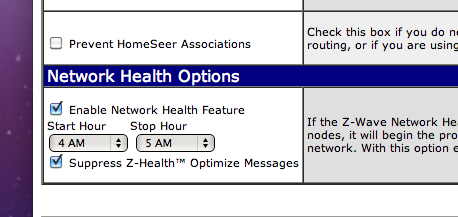

Are you optimizing your network?
You need to do that at least 3 times after adding a device.
Also schedule network optimization every night.
You will find that in zwave management screen

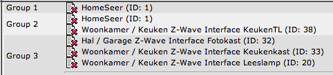

Poll is just question of money.
In Zwave protocol there is also option for instante update.
ACT_ZRM230 is doing that.
I think other problem is Homeseer that is not picking up the status changes.
see the next two examples.
Act is working fine when it's associations to Homeseer
Duwi is not updating the status with the same config.

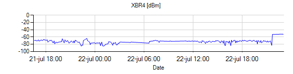

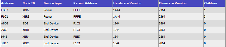

Here's an example of a self healing/optimizing network. Since a few hours one of my XBees is using a different route to my coordinator, resulting in better (last hop) signal strength (remeber, this is a decibel y-scale):
I took a look what had happened and saw that this node (XBR4) changed its parent to node XBR2, where it used to be node XBR3:
I did nothing.. nor did my system; it just happens. That's how it's supposed to be.
