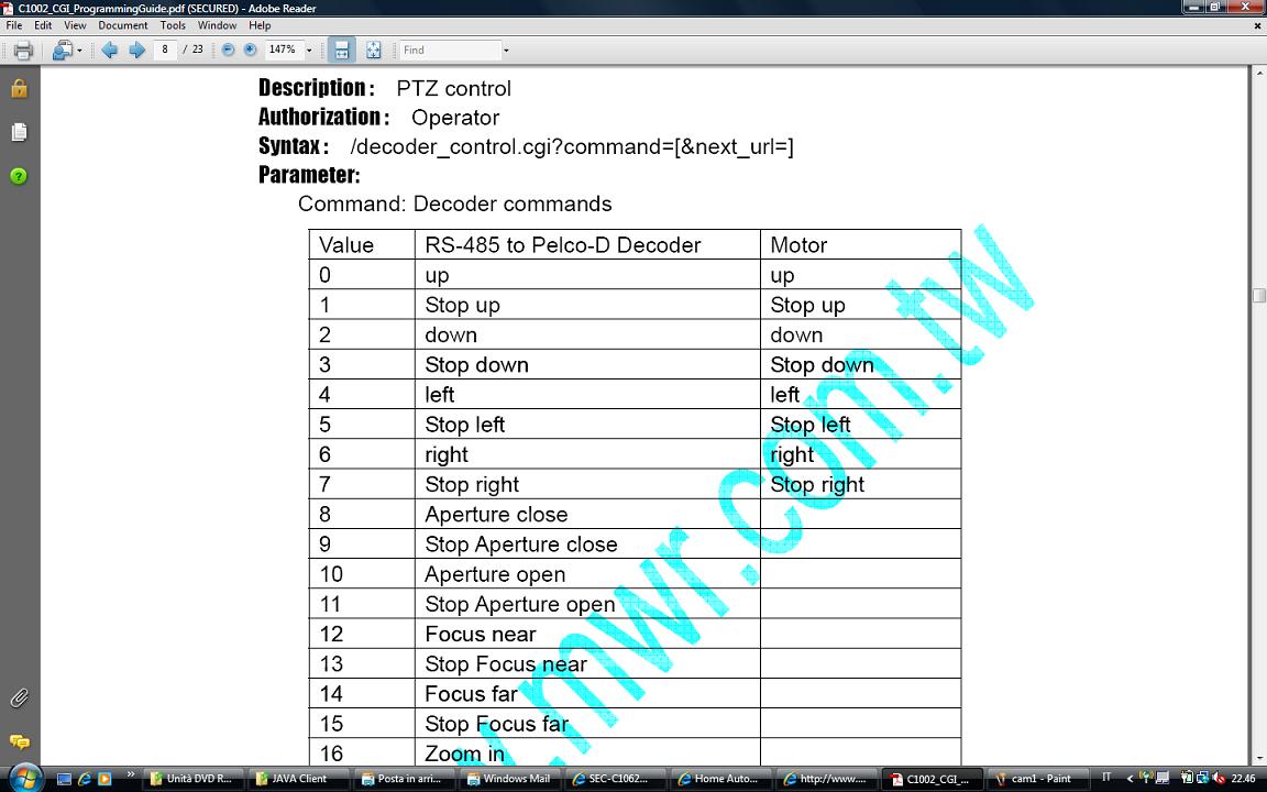

Hi All, i bought a new camera with pan/tilt http://www.mwr.com.tw/ip-camera/c1062r.htm
here a manual http://www.solwise.co.uk/downloads/files/c1002qig.pdf

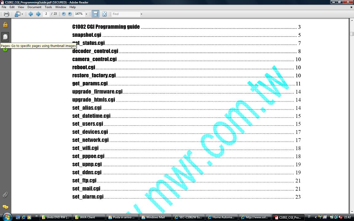

I need some help because i'm not a programmer: in camera cdrom there's a document
called programming guide with HTTP-API that make me think i can automatize some jobs with explorer.
i have Homeseer, and by conditions i could force camera to move to a desired position automatically , or i think so..
i can not UPLOAD the pdf because is bigger than 300k
see the screenshot.
i can send the pdf to who could help me :D
thanks for support

Hi John, i'll try but i see this is used for live feed into HSTOUCH. I would like to do this :
cam has pan tilt so can move to preset positions
i set some positions in it
ms13 can detect movements and send info to HS
i create an event about it , with action : launch program - my program is IE with some code of the API
camera moves to preset corresponding and because it has screenshooting camera takes the picture of the movement .... along 360 degrees , by itself 8) . That's my idea

Ok camera works, with simple code in the address bar of explorer.
now i need a little help.
what is the code to make homeseer start explorer and navigate to a web address?
hs.launch...... DON'T KNOW , please help

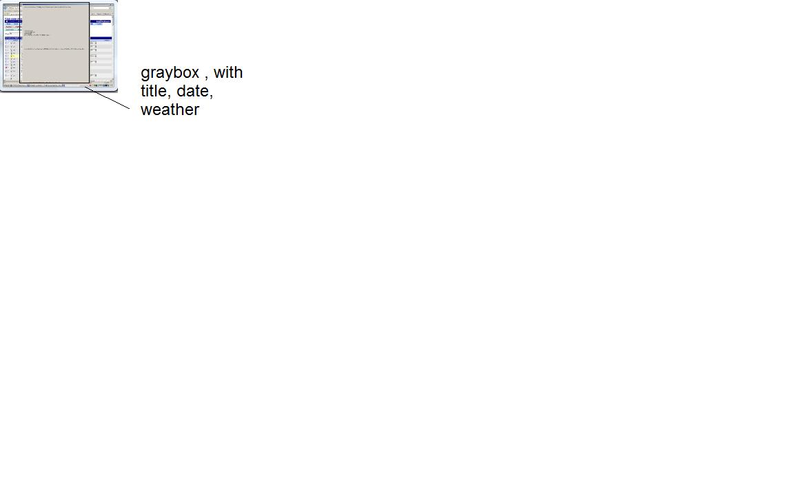

Strange, with GetURL i see a GRAYBOX without html-formatting
example this point to CNN.COM
sub main()
dim page
page = hs.GetURL("cnn.com","/",TRUE,80)
msgbox page
end sub
