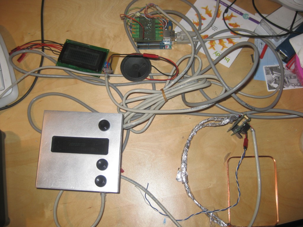

It is ready for mounting. Top of the pic shows the arduino and ethernet shield. On top is the homemade shield with the doorbell IC and connectors.
To the top left is the indoor lcd, speaker and connections for buttons/reedswitches. I will try to find a enclosure for this tomorrow.

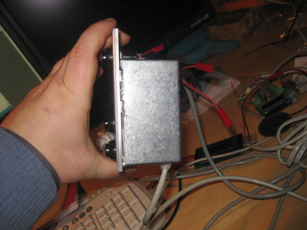

Bottom left shows the outdoor unit. This is sealed in an aluminium housing.
To the right is the powermodule, rfid reader and anteanna. Antenna cables are stylishly wrapped in tinfoile ( I did'nt have any coax cable). The blue and white cables are for connection to the doorbell trafo cables. I can run all of this by connecting a 9v battery to them.

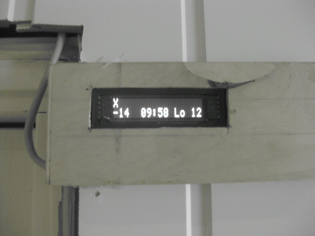

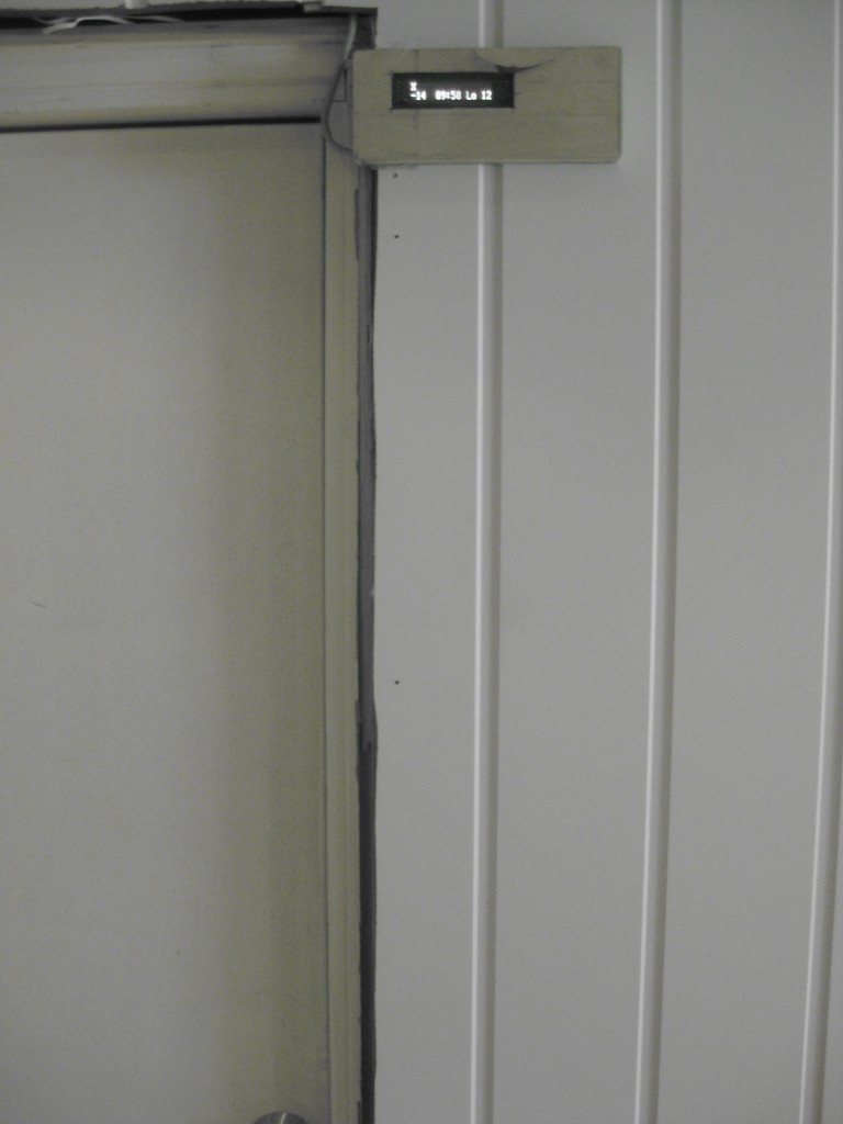

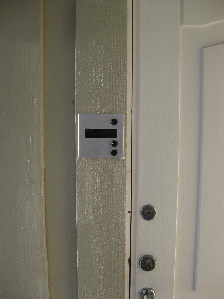

The semi-finished installation: The setup has been working since december. The outside is done, all i have left is to sand & paint the inside wooden box when I put up the flush woodwork around the door.
Youtube video : http://www.youtube.com/watch?v=e7Udrjz-Y-g
Outside
Outside
Inside: &quot;X&quot; shows that front door is closed, &quot;O&quot; that it is open.
Inside: "X" shows that front door is closed, "O" that it is open.
A short list of the functions:
  • Doorbells: Mario theme for the kids, regular for us and tenants

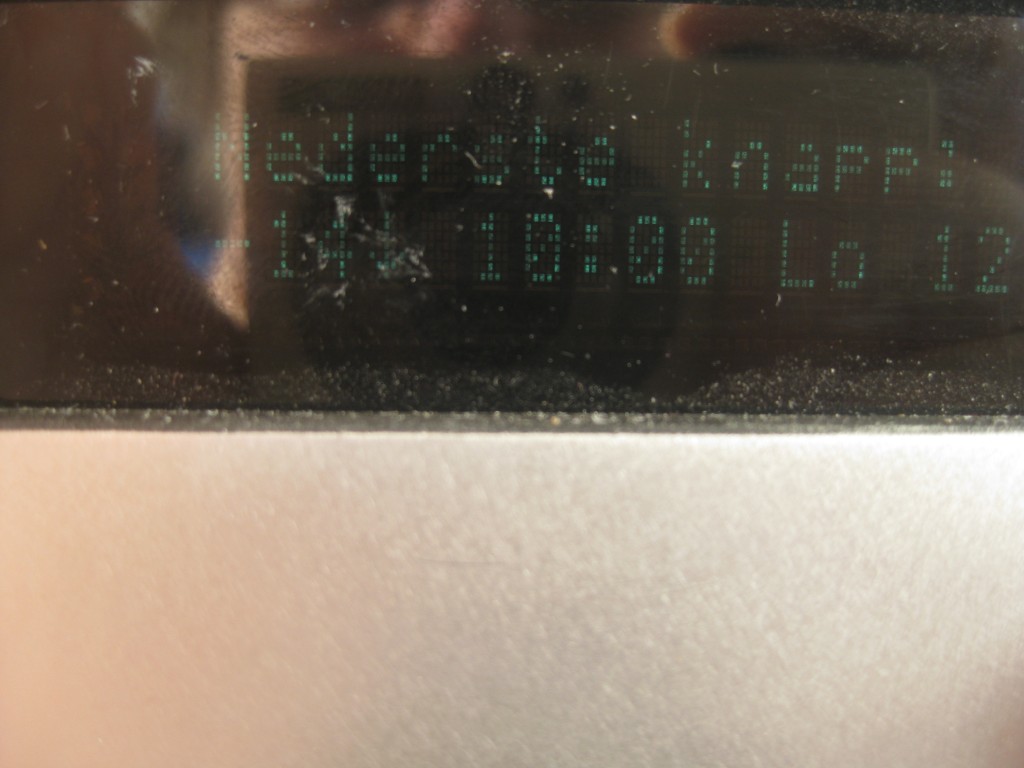

    Displays: Currently displays outside temperature (and outside falling/rising) read from Domotiga datbase, date time from ntp-server, day of week.
    Outside display also shows which button goes to whom: A perl script on server sends this menu to the outside display. Both displays can be used form the server

    RFID: Reads rfid tags, here I need to get the antenna monted against the inside of the panels, range now is too short. Also stores, deletes and reads rfid-tags to/from the eeprom memory through udp-packets sent/received by the server.
Display inside
Display inside
Outside display (obscured by direct sunlight)
