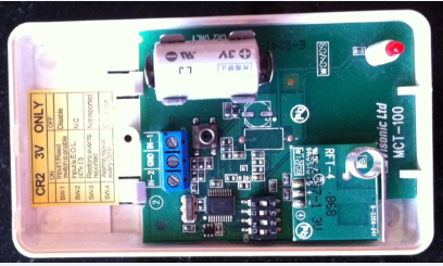

This is a picture of my MCT-100:
What I see is that the following unputs are there
- IN-1
- GND
- IN-2
I know I need to use
IN-1 for my Doorbell for example and
IN-2 for my Magnetcontact

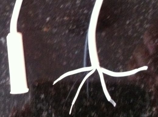

When I look at the wires of the Magnetcontact I see 4 wires:
QUESTION 1:
Where do I put these 4-wires?

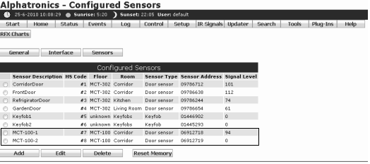

I can only see that MCT-100 #1 is sending a signal and MCT-100 #2 is NOT.
how do I fix this?

Basicly second contact only works if you put a jumper correctly, and the 4 wires for the wired contact just take a multimeter and check when it changes value, easiest way to find it.

from the magnetcontact you need only 2 wires to connect to IN-1 and GND.
If you have no multimeter you can try them out with the connecting the magnet to the contact (1-IN and GND) and the MCT-100 should start to send (LED blinking).
On the other contact (2-IN and GND) you can connect the Pushbutton of the bell, schematic is on this forum, depends on your doorbell setup? search for doorbell on forum.
It is right that you see only Input 1 of the MCT-100 coming in with a hartbeat, only that port has a heartbeat, the other port (IN-2) only sends if status is changing, NO hartbeat.
