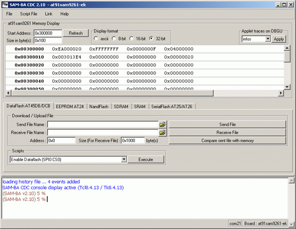

Just got my evohome/evotouch and was interested about that USB port...
Once you connect it with the device on, you get a USB error (Device is VID=0000, PID=0000).
Take out one battery, then connect the device, and put the battery back in. Voila! The device installs as a new USB COM port (Win7 recognizes it as "WinARM GPS Camera Detect" falsely).
OK, next download SAM-BA 2.10 from http://www.atmel.com/dyn/products/tools ... ol_id=3883
and install it.
When starting the tool, you'll be asked for the COM port your evotouch installed on earlier. I just chose the board type mentioned earlier in this thread.
There's an error msg, continue with <yes>:
After that, you'll see the SAM-BA UI.
I hope this is a good starting point for doing some further research... :)
