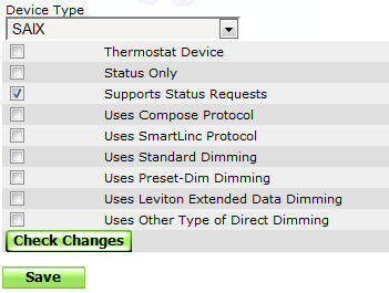

Xanura daix/saix status request
Re: Xanura daix/saix status request
Thanks for the screenshot.
To bad it is the same as my settings
