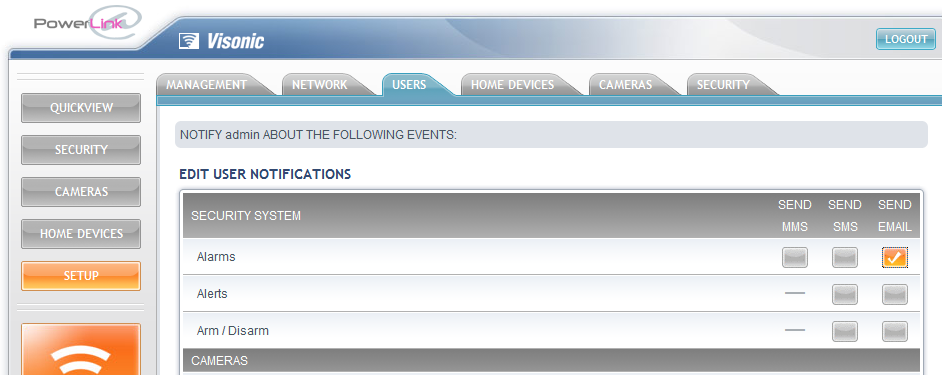

Does anyone know how to make the powermax/complete sent out an email upon an alarm/event?
I thought it would be possible with the 'central station' but its only a DynDNS!? Or am i missing something?

Actually the solution architecture is unclear to me. I thought the powermax complete didn't really have ip support, only simple rs232 support or something alike. Then the powerlink2 adds ip support, webbrowser that sends simple commands to the powermax-complete. But then how would this setting be effective? I would expect to enter an email address somewhere in the powermax menu's (such as under CS Reporting; it only has "IP RCVR 1 and 2" (whatever that may be???)

I have asked Visonic about this. See also this post:
I thought it would only really work if you have completed the PowerLink registration in the web interface.
This did not work, I thought that port forwarding was necessary. It did not matter.
Eventually, after much fiddling, I read the Visonic PowerLink page again. And again:
"Utilizing PowerLink2 as an IP-based event notification solution requires that Visonic's IPMP (IP Management Platform) be implemented as an IP receiver at the central station." visonic.com/Products/Wireless-Property- ... 2-internal
Eventually, I hope there will be a solid interface with HomeSeer. Would like to write a driver myself, if I had the time.
Ultimately, there will be a dependence on the PC and Homeseer to send the e-mail. Perhaps the GSM module is a better choice.

I thought it was like that.
The email etc are in the powerlink.
Visonic's IPMP is communicating with the powerlink, if an alarm is set of the Visonic's IPMP software receives this (Ip Notification or something).
And the Visonic's IPMP is sending the email/SMS.
So you need to program it in your own software

I got the Powerlink2 sending e-mail, see domoticaforum.eu/viewtopic.php?f=68& ... 314#p55314.
