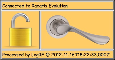

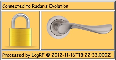

Inspired by Websockets and MQTT I created the following to monitor and control my front door ... I believe the pictures say it all ... Ohh when you click on the door handle it unlocks the door ... I think it is very cool :D

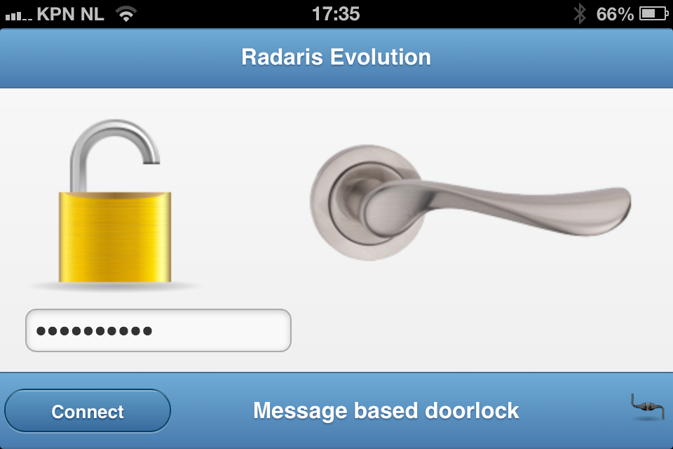

Now available on the iPhone - just as an example that it works ... Introducing authenticated mqtt messages ...
Tue Nov 20 17:18:16 2012 Cmd: unlock:7dbc02cfd96ee740dfb4e931be3a6b3e5c5672cb318ce330ca507db68afd3d91
Tue Nov 20 17:18:16 2012 Remote Access granted
Tue Nov 20 17:18:16 2012 Execute: unlock
Tue Nov 20 17:18:16 2012 <ack received>
Tue Nov 20 17:18:17 2012 < kruk gekoppeld ontgrendeld >
Tue Nov 20 17:18:21 2012 < kruk ontkoppeld ontgrendeld >
Tue Nov 20 17:18:21 2012 < kruk ontkoppeld vergrendeld >
Tue Nov 20 17:25:45 2012 Cmd: unlock:440c37bd2b6e42c03b26d5fd464309d3b2605fc35b8d015082d28ebbf2ddff13
Tue Nov 20 17:25:45 2012 Remote Access granted
Tue Nov 20 17:25:45 2012 Execute: unlock
Tue Nov 20 17:25:45 2012 <ack received>
Tue Nov 20 17:25:46 2012 < kruk gekoppeld ontgrendeld >
Tue Nov 20 17:25:51 2012 < kruk ontkoppeld ontgrendeld >
Tue Nov 20 17:25:51 2012 < kruk ontkoppeld vergrendeld >
