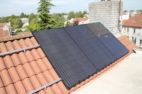

Here you see how easy the clickfit system is which i'm gonne use for my MetdeZon solarpanels

I have installed my own panels, 6 in total. Took me half a day with 2 people, using the click-fit system.
If you're not afraid of working on the roof I would recommend doing it yourself, since most company's ask quite some money to do the installation.

It looks do-able.
I'm a little surprised that the guy just walks around the roof without safety..
And the 2 extra panels laying horizontally look ugly. I would have left those out.

Leaving 2 panels out is not always an option. For example, on the mastervolt soladin 600 you need 3 panels to get enough voltage.
That's also the reason why you have to be carefull with shadows and suchs. During the early morning, one of my solar panels is in the shade of the chimney, and then neither of those 3 panels provide any electicity.

wwolkers wrote:Leaving 2 panels out is not always an option. For example, on the mastervolt soladin 600 you need 3 panels to get enough voltage.
In that case you can use a low voltage inverter, where you connect the panels parallel.
With 1 panel in the shade, the other 2 will keep on delivering power.
