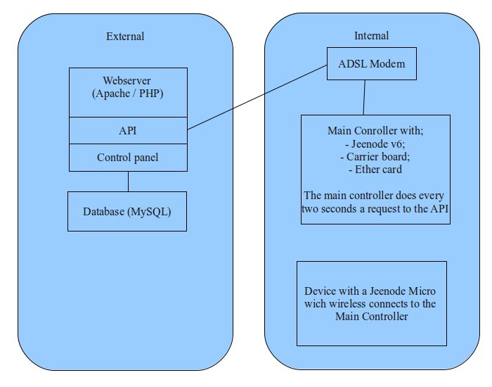

Thats right, while i was searching too Jeenodes I came also on your blog where describe to made an ethernet doorbel. See the attachment with my schematic design how I want to make it.
- Schematic design
- schematic.jpg (40.46 KiB) Viewed 8624 times

Just a remark, if you will use your schematic design for your paper for school, i would change the "wich" in "which" otherwise you refer to a "heks".
Alexander
