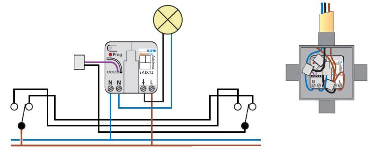

Maybe this could solve youre situation it did for me:
Puls switches to turn the light on/off
Hotel puls.jpg (3.24 KiB) Viewed 15516 times
The Xanura SAIX12 will accept switched and puls signals to change it's state. With only 1 switching wire you can switch at many different locations.
You might want to see oif a similar KAKU unit is available.
Regards, Maarten.

I also looked at the SAIX12 but I could not find a X10 remote conreoler that I can screw ON to the wall (like the WST-8800)
I could connect the SAIX12 in the following manner if I had a remote control like the WST-8800.
Unfortunately there is no possiblilty to add the 3rd switch wired, and the ceiling is more than 4.5 high so also a remote switch in the ceiling is not an option.
