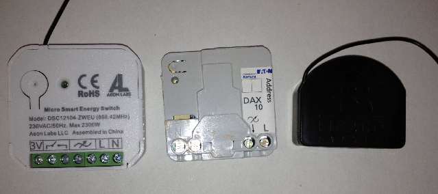

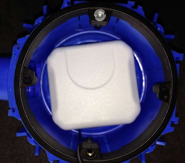

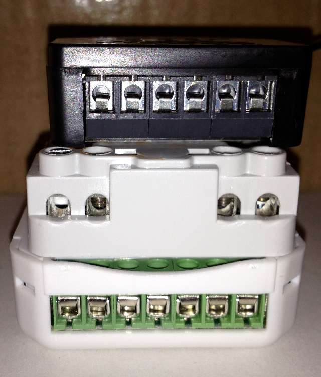

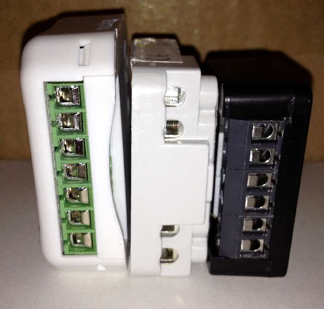

First thoughts and some pictures.
They are BIG!!!
You will need 50mm to build them in.
there is not so much space left for the cables.
They are BIG!!!
- 4.jpg (45.79 KiB) Viewed 11590 times
- 3.jpg (44.3 KiB) Viewed 11590 times
- 2.jpg (58.75 KiB) Viewed 11590 times
- Aeon - Xanura - Fibaro
- 1.jpg (29.71 KiB) Viewed 11590 times
Re: New zwave products from Aeon Labs
Wow, they need 50mm deep boxes. That's scary. I thought they were only 18.5mm thick (about as thick as the fibaro)

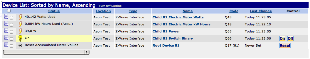

Homeseer:
After adding the device homeseer will create 5 devices...see the attachment..not sure what the difference are between the devices.
In the association tab there is only one groupe.
I have added this to Homesee...Status will not be updated when manually controlled.
When adding poll time in root device this will update the status but not the usage.
Not sure how to update the status of the usage since there is no poll option in the settings of the device. You can use events to do that...
All of this not making me happy...
Will check the documentation for more option..
the included docu is only 1 A4..no talk about options etc..

Little bit more information about Homeseer support.
The latest version of Homeseer is not working wel with Multi Channel CC
This is the reason of the not updated status problem.
Homeseer is working on this problem and they hope to solve it in the next update.
