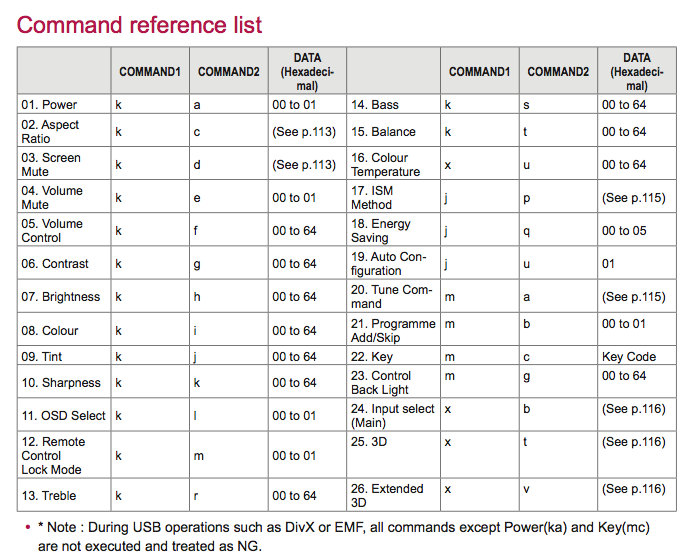

While looking for a TV in de bedroom I ran into a model with an RS232 port.
(LG 32LV2500 lg.com/nl/tv-audio-video/televisie/LG-l ... LV2500.jsp)
(manual: lg.com/nl/common/product/support.jsp?lo ... V2500.jsp#)
Page 110
This port can be used to connect to an external control device (like PC). What can be controlled?
Screenshot of LG TV RS232 commands
Screen Shot 2012-01-25 at 10.19.57 .png (107.66 KiB) Viewed 16567 times

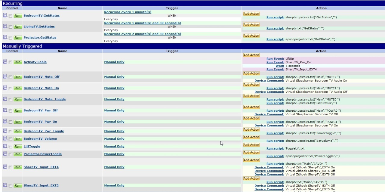

Here's my script to control my sharp aquos tv in the bedroom:
Sub Main(parm)
	'add spaces if neccesairy
	Do Until len(parm) = 8
		parm = parm & " "
	Loop
	Dim retVal
    	'hs.WriteLog "SharpTV", "Execute: [" + parm + "]"
	hs.SendToComPort 14, parm + vbCr
	hs.WaitSecs(1)
	retVal = hs.GetComPortData(14)
	'hs.WriteLog "SharpTV", "Response: [" + retVal + "]"

And here's a screenshot of some tv events, I have 2 sharp aquos tv's in the house.
