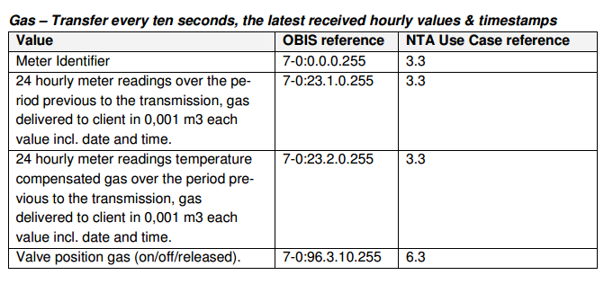

The standard has the following information regarding resolution (electricty):
And, the standard has the following information regarding gas resolution:
I think I will be just fine with this type of resolution...
