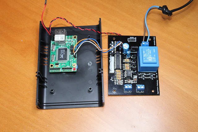

As most of you know, i like everything IP Based, so I decided to connect to OTG to the Antratek EZL-70 Ethernet module http://www.antratek.be/Sollae.html
This module has a TTL input, so I left the MAX232 out and connected the PIC directly based on TTL via 3 wires.
The EZL Needs 5 volt, so I thought to connect this to the UA7805 volt regulator on the OTG.
This gave a strange effect, the UA7805 is getting very hot and immediately the total power consumption rose to 2 watts?
Its now on a separate powerline and then both devices are consuming almost nothing (can not measure it, so low)

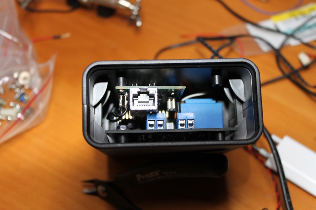

The EZL-70 is just small enough to just fit in the existing housing, With 2 screws it can be connected to the upper part of the casing

Nicely done, although it is weird that you need a separate 5V supply. This option would be much more usable for many people if you (or someone else) could figure out how to make it run on the 5V of the gateway. The EZL-70 user manual seems to suggest that is exactly how the device is intended to be used.

Like I said when we met last week, you need an additional capacitor of 100nF (ceramic) parallel at C2 (now 100uF but I guess 10 uF would be better) to decouple and avoid oscillation. Looking further at the schematics of the gateway I'm missing a decouple capacitor at IC1 as well. In the old days I remember this to be best practice, no clue why it has been left out, but it doesn't hurt to add them.
See below illustration borrowed from cicruitsonline
Regards, Willem.
Re: Bwired Opentherm Gateway solution
I tried that immediately after you told me this in Eindhoven Willem but did not work either, the 7805 got less hot, but still 2.4 watt current.
Willem4ever
Posts: 805
Post by Willem4ever »
It is a linear regulator, which means output current is input current and the additional power is dissipated as heat. Now 24 volts is a rather high and in efficient voltage to feed a 7805 ..... usage of the EZL according specs ~ 60 mA x 24 V = 1.44 W .....
