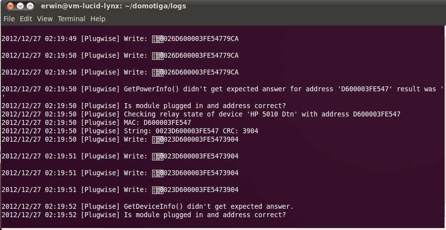

Status update:
Domotiga sees my Plugwise stick allright.
I've entered the Circle+ and a couple of others as new devices.
Still there is no output from my Circles...
I started DomotiGa standalone from the terminal.
Then i get:
ERROR: you must define at least one Data Source.
To me it seems my Plugwise stick should be a Data Source.
QUESTION:
My firmware dates from 2010-11-01. Could this be an issue?
Can I issue some command (PHP related?) to try and poll my Circle or try to have it switch?
Thanks for any suggestion!
Erwin

I've made some progress though.
I found here on the forum the long list of Ron's updates, and realized there are incompatibilities between Plugwise firmwares that have should be solved in later releases.
So I've just installed a new VM, lucid lynx based, and did a fresh install of gambas and domotiga. Both without any problem.
So Domotiga is up and running on this new VM. (1.0.002)
Next I connected my Plugwise stick. It is visibly connected. I noticed I can choose the firmware now, so I chose 2010.
But still the circles won't connect...
I'm under the impression something is wrong with the MAC addresses?
Erwin
screenshot of logfile
Screen Shot 2012-12-27 at 02.20.45.png (169.52 KiB) Viewed 15172 times

Post by j.hoekstra »
I got a suspicion you filled in the MAC-address wrong:
When opening a device-property on one of the plug it gives you an example of the number:
000D6F000021811A
you have it as:
D600003FE547
Since I set it up a long time ago, I don't know if the first 10 numbers are supposed to be:
000D6F0000 and the last in your case 3FE547, but it wouldn't hurt to try.
The first 10 seem to be fixed and the last is the MAC-number from the plug.
Hope it helps, good luck

Thanks for your observation!
However, the MAC address is my greatest suspicion for now.
I actually copied the leading 10 figures from the example.
But as this won't work, and as I notice these weird figures as my first 3 address name characters, I've been trying to add them, with leading 000* and without...
Nothing seems to work?

This is what mine shows:
erwin@vm-lucid-lynx:~$ ls -al /dev/ttyUSBplugwise
crw-rw---- 1 root dialout 188, 0 2012-12-27 12:51 /dev/ttyUSBplugwise
So apart from the 0 after 188, which I don't know what it means, it all looks the same, and should be fine too.
DomotiGa is starting up fine, after I adjusted the serial port name, it reports
But when watch the debug-2012-2.log, it reports:
erwin@vm-lucid-lynx:~$ tail -f /home/erwin/domotiga/logs/debug-2012-12.log
2012/12/27 12:55:25 [Plugwise] Write: 0023000D600003FE547BC2E
2012/12/27 12:55:26 [Plugwise] Write: 0023000D600003FE547BC2E
2012/12/27 12:55:26 [Plugwise] GetDeviceInfo() didn't get expected answer.
2012/12/27 12:55:26 [Plugwise] Is module plugged in and address correct?
So this points me in the only thing left and indicated by the log:
...[Plugwise] is module address correct?
I repeat:
If I switch the Plugwise USB stick to my win7 VM, plugwise is working 100%
Does anybody know of a (free) serial port sniffer I can use to check communication under windows 7?
I can't think of anything else..

Can you change the device-adress to:
000D6F00003FE547 ?
Afaict you didn't fill in the number correctly and you missed the F after D6.

Thanks for pointing out! You're absolutely right.
Did the test, messages change a bit, but still no connection.
I'll post a snippet tomorrow.
I've done some more testing, and I'm on to something that's got to do with the firmware version.
What I've tried is too complicated to write down in 2 words. Need to do some more testing, but will report back shortly.
I might perhaps try to set firmware to 2009 for that matter...
