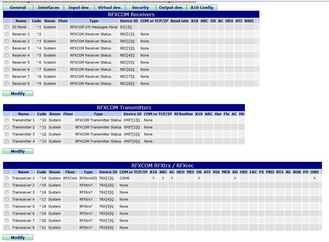

Yes, this is my config.b_weijenberg wrote:An AC1000 is a receiver and does not transmit RF
You have only the RFXtrx433 configured?
- RFXCom
- rfxcom.jpg (75.77 KiB) Viewed 7346 times
- b_weijenberg
- Forum Moderator
- Posts: 1746
- Location: Netherlands
Re: Error: INFO: ACK, but transmit started after 6 seconds delay
configuration looks OK and could not introduce the problem.
