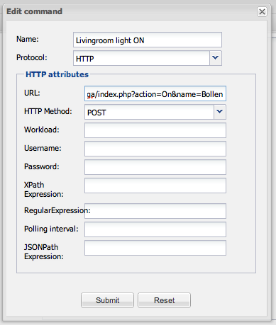

I am in the process of creating a ipad remote for Domotiga with the use off OpenRemote.
Easy commands like on and off on differend buttons is no problem with http post commands.
Screen Shot 2012-10-02 at 12.39.47 PM.png (36.08 KiB) Viewed 6994 times
What about getting status from devices? to create a "switch" wit On/Off status you need to get the result back fro a http get command. Can I use the XML-RPC implementation to get values of devices or control.
If someone can point me into the direction that i need to follow?
