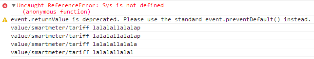

I get this, does this mean it's working? :lol: :lol:
Kroonen
Posts: 302
Re: mqtt and Apache and mod_websocket_mosquitto
Post by Kroonen »
Ron,
That solves it. thnx
@Robert,
Now te values are now better. Ialalalla :lol: :lol:
regards Richard
