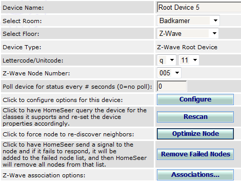

    For example, I have a single Fibaro relay switch thats behind a normal wall mounted switch. When i include this it shows up as a double switch where only Inst1 is working
    The configuration screen looks like this
    I see that polling is set to zero. I can't imagine that i have to poll each device every second to get a realtime update of my switches
    I've setup the association like this but i tried also group 1 and 2 for that matter but no status updates in HS2
    And advice will be welcome.

    If I look at a switch I get four devices. In your screen I only see three. That's strange. The one I use for status is exactly the one I see missing. It's named binary (without inst 1 or inst 2).I think the inst1 and inst2 can be used for other actions but are not the devices who carry the actual status of the lamp.
    Please try to re-scan the root device and see if you then do get the fourth device. It took me a couple of times rescanning to receive all the devices.
    Next to that I write down my HS2 version: 2.5.0.80
    Can you check if you can 'find' the fourth device?

    I did't get a 4th devce even after 15 re-scans
    So i updated the firmware of the z-stick -> no succes
    Renewed devices and reloaded them + re-scans -> no succes
    Then i noticed your HS2 version
    I was at 2.5.0.20 and the updater on the download page showed me that .81 was available. Looking at the release notes there has been lots of z-wave fixes so i took the dive and upgrade my stable system. Did a rescan and there 2 additional device popped up. You are right, the binary device reports the state.
