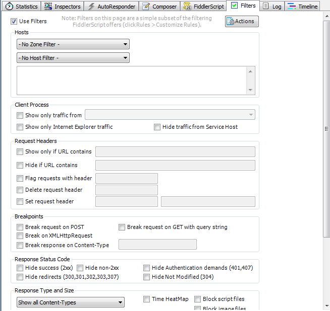

Robert, I did not yet. But will certainly try that tonight. Like to understand if debug changes the behavior or maybe affects timing of things. BTW. I am still trying to figure out how to use Fiddler in this case. I have Fiddler installed on the homeseer server and it see all outgoing connections to for example a webcam. How do I get it to monitor incoming requests to the HS webserver? (Installing fiddler on the arduino unfortunately is no option :( )
Morten, unfortunately changing the gateway is not really an option, the interface is provisioned through DHCP (reservation) and the GW is assigned automatically. Looking at the behavior (works when debug is on, stops when debug is off) I do not expect this to be related.
Francois
Re: ARduino / Homeseer / tenHsServer
All kinds of filters available:
