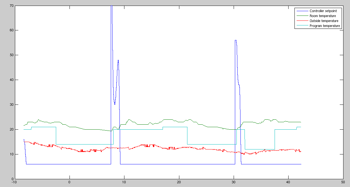

Before designing a new controller, let's first have a look at what's already there.
Did a few days of continuous logging (and still continuing), one thing strikes me as a bit odd.
(see attached image, horizontal axis: hours, zero is yesterday's midnight. vertical: temperature (degC) )
The boiler starts heating even when the room temperature is at the level required by the program (near the second peak in the controller setpoint). Overshoot in the room temperature is up to 1 degree. Quite a lot for a modulating, learning controller, I think.
Besides that, never mind the room temperature, I've had my wood-fired stove on for the last few days (during the day, the overshoot in the morning has got nothing to do with that, the stove is not on yet, then). The room temperature is not really updated continuously: it seems to "hang" when the level hits an integer number. Don't know why, could be the toon ketelmodule firmware, toon software, whatever. Not very interesting, the boiler doesn't use the number. Will make a combined, direct readout from the thermostat, had no issues with those readings before.
Will try a few days without wood-fired stove, see if I can find typical heat losses for my house (it's not really cold yet, overnight temperature loss is quite limited).
grtz,
