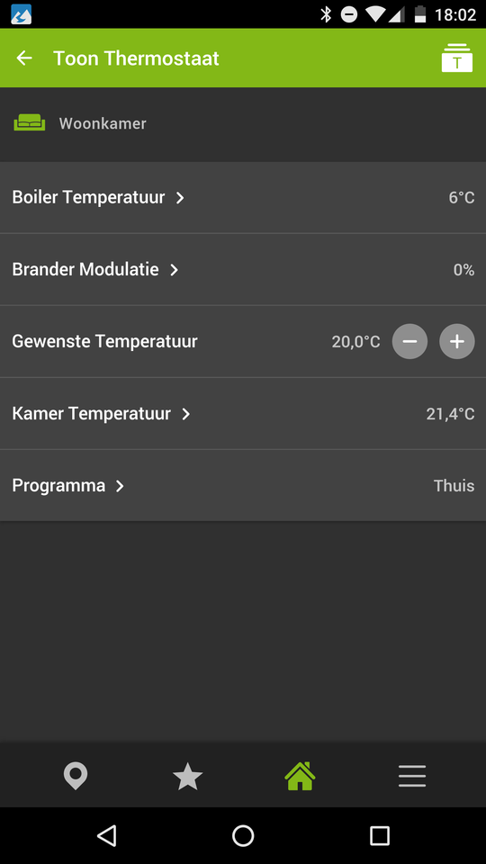

Eerste integratie van Toon met Loxone.
Regards, Ron.
The 6 degrees look like boiler control setpoint rather than a boiler temperature (there are three of them: CH output temp, CH return temp, DHW temp, take your pick :-)).
Otherwise: nice feature.
