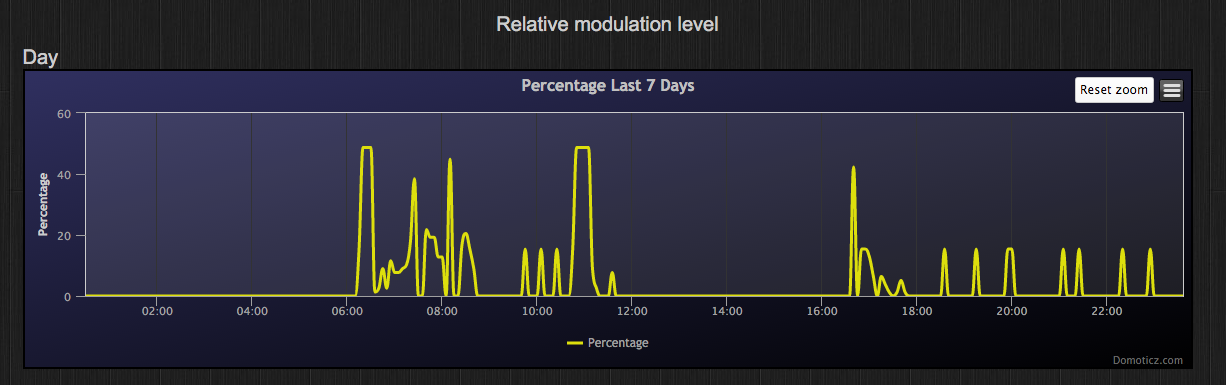

The log for OT14 (same day as previous Control Point log):
OT14
OT14
Screen Shot 2016-01-15 at 10.26.28.png (223.51 KiB) Viewed 16978 times

Re: Does my Honeywell Modulation modulate?
It's modulating allright, but also oscillating a lot. It means that currently you only need a moderate power output from your boiler (less than power at minimum modulation level).

Your thermostat is requesting a desired boiler temperature and the boiler is modulating the desired power to achieve the boiler setpoint temperature. From the pictures you sent it is working good. The oscillating part between 13:00 and 15:00 h (picture in opening post) is the so-called Low Load control of the thermostat. It means that below a certain modulation level the thermostat switches from a continuous low requirement to a kind of on/off control to maintain the room setpoint. The boiler is switched on about 6 times per hour for several minutes. The boiler temperature setpoint is being set according to the calculated heat loss of the room.
Have a look at the installers manual of the thermostat. You can switch off the low load controll in the settings, and watch the effect on the control.
