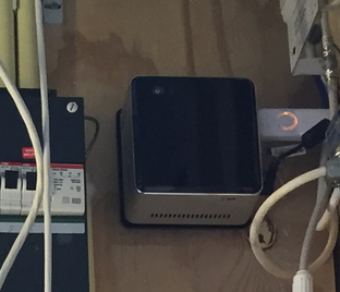

Last summer I ordered a new server for HS3
1x Intel / NUC Kit DN2820FYK - € 142
2x Kingston Technology / KVR16LS11/8 KVR16LS11/8 - € 50
1x Samsung / 850 EVO - 120GB MZ-75E120B/EU - € 72
Total: € 265
Power: between 6-10W
Like: small, low power, only a tiny fan
OS: w2007
intel nuc
intel nuc

So few USB interfaces ?

That is nice and small indeed, price is at the moment 144 euro for this device ex harddisk and ram memory.
