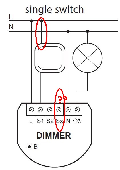

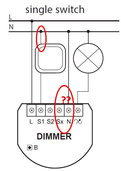

I searched a lot regarding how to connect this dimmer.?

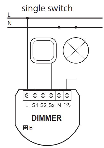

We all know the 'standard connection scheme':
Now, the momentary switch is NOT in the same location as the dimmer module (not enough room) - so, I was wondering if either of these options were possible:
If yes, how do I connect the Sx connector????
thanks for any help!!

Take a look at Diagram E
domotique-info.fr/wp-content/uploads/20 ... gd-212.jpg
Think that fit's your need.
Hope this helps
