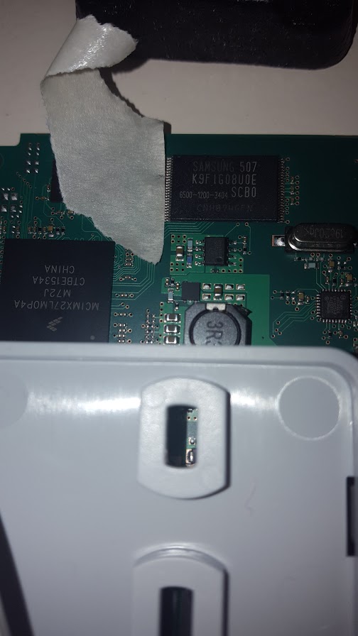

Hello, i have bought myself a Toon and started to root it but unfortunately, i have a recent firmware ( U-Boot 2010.09-R10 (Dec 14 2015 - 19:28:18) ) and i was not able to find a bootloader password for this.
I've tried to short the circuits of the Nand Chip, but in my Toon, also a new version of this chip is placed ( Samsung 507 ). So i was unable to get into the u-boot by this method.
So, is there a possible way for me to root Toon ?

Moved your post to the right topic, and no, your Samsung chip is not very different from earlier versions. The type is: K9F1G08UDE.
Your u-boot version has a properly hashed password (and is unknown). So, the two ways to get in are: ask Quby (see earlier post by Templar). or: build a new u-Boot (from source) and flash it onto your toon with a JTAG programmer.
I have no experience with the first method, and the second is still (a bit) under development.
