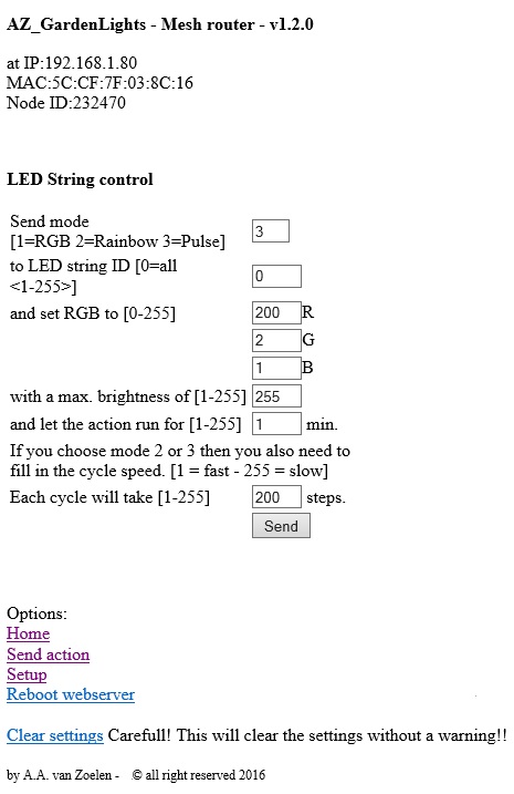

No, there is more. The use of a serial connection can be by-passed by using an AZ-Mesh router module. This is a webserver that serves webpages to let you control the LED strips via a webpage in a browser or with direct HTTP requests. The webserver then translates the request and send the right control string to then Mesh node.

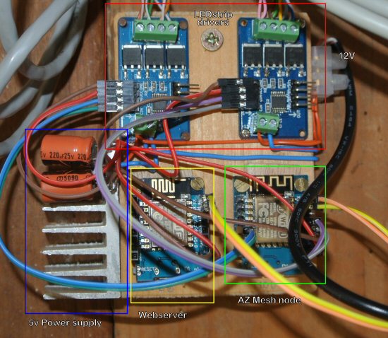

This is the Mesh node i have in my garage. It's the entry point to the mesh network. Because i only have a WiFi signal available at that point i use a Mesh router (webserver) to get my commands into the netwerk.
As you can see it is build in a modulair fashion so if something breaks you only have to replace one part of it.

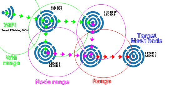

This i how it function
You want to turn on led string with ID 9 but that one is out of range for your local WiFi.
The command is send into the mesh network and each node sees if it got the ID. If not it will be forwarded to ALL nodes that it can reach. If the message arrives at a node that got the right ID then the message isn't forwarded anymore and will be executed. If a node receives a message that it already had processed by forwarding it or executing it then the message isn't forwarded anymore. This is to prevent that a message will hop endless around.
The command it receives is stored locally so when a motion detector is connected to the node the stored settings is used to activate the light pattern. The code can handle call back messages such as notifying back to the WiFi AP that a motion detector has triggered. However for now i don't use that functionality because i don't have need for it.

1 Wemos D1 Mini (2 if you want to use a router too. This is needed only once)
https://www.aliexpress.com/item/D1-mini ... 0.0.2dx0mL
Using cheap parts also means rhat you must accept crappy hardware from time to time.
The Wemos D1 mini is preferred because you can program it more easily and just via an USB cable. However the used FTDI chip isn't the best one so it fails sometimes. You can still program the Wemos via the RX/TX/GND pins. To do so you have to put pin D3 to GND and you are able to program them.
I find the ESP platform a very unstable platform to say atleast. It is an absolute must to have a good and stable power supply that can deliver atleast 300mA. Otherwise be prepared to retry flashing multiple time before you get a succesfull flash.
Ps. The Wemos is based on ESP8266 thus is a 3.3V device. However because the Wemos accepts also USB power there is also a 5V pin. It is possible to power the Wemos via this pin with 5V. This makes the wattage dissipation a bit friendlier for the power supply that converts the 12V power for the LED strips down to 5V instead of 3.3V This way you can power it with just one adapter.
