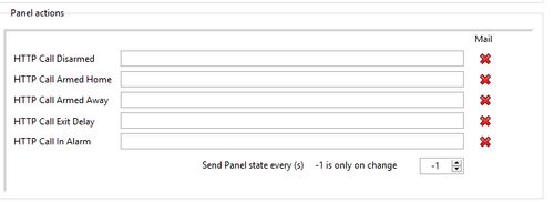

Hi.
I am new to this and unsure which HomeSeer JSON call to write in panel actions. I know what to write to set a virtual device on but what do I write in panel actions to get both on and off?
Regards
Morten
johnz
Posts: 144
Re: Visonic Powermax Interface (Windows) application
Post by johnz »
Hi Morten,
This is not about on or off (as for sensors). This controls the virtual device that reflects your panel state. Just create some status values for this virtual device (1 = disarmed, 2 = armed home etc) and then the http call for disarmed is the JSON call you know (value =1), and so on.

bartbakels
Posts: 515
Post by bartbakels »
mhn,
John, beats me to it ;)
Indeed just create a virtual device, with the 5 panel states, and call the corresponding json control string.
regards
Bart

mhn
Posts: 399
Location: Denmark
Post by mhn »
Done that a long time ago. ;-)
