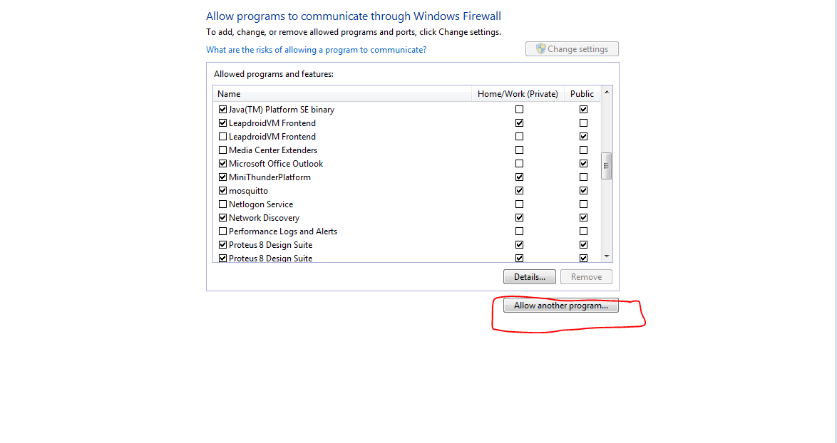

did you check the firewall on you`re windows 7 machine, and verified that Mosquito is actually running?

I manually added Mosquitto in windows Firewall and now it works
Thanks
