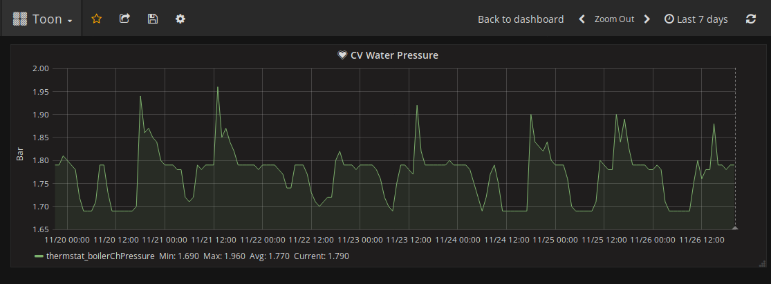

I whipped up this small python script to import all boiler water pressure data from last year.
#!/usr/bin/python
import requests
toon_url = 'http://192.168.178.133/hcb_rrd?action=getRrdData&loggerName=thermstat_boilerChPressure&rra=year&nullForNaN=1'
db_url = 'http://192.168.178.113:8086/write?db=toon'
headers = {'X-Requested-With': 'Python requests', 'Content-type': 'text/xml'}
values = requests.get(toon_url).json()
for timestamp, value in values.iteritems():
    print(timestamp, value)
    payload = 'thermstat_boilerChPressure value=' + str(value) + ' ' + str(timestamp + '000000000')
    r = requests.post(db_url, data=payload, headers=headers)
Steps to do before running this:
Install influxdb and grafana
Create database to store data ('toon' in my case)
$ influx
Connected to http://localhost:8086 version 1.3.6
InfluxDB shell version: 1.3.6
> CREATE DATABASE toon
Change script to reflect your toon and influxdb server urls
Also the data you want to copy (tested with thermstat_boilerChPressure)
Add datasource in grafana to use influxdb and db toon
Create dashboard and graph to display data you want to view like this.
You can see when the CV got it's yearly maintenance ;)
Regards, Ron.

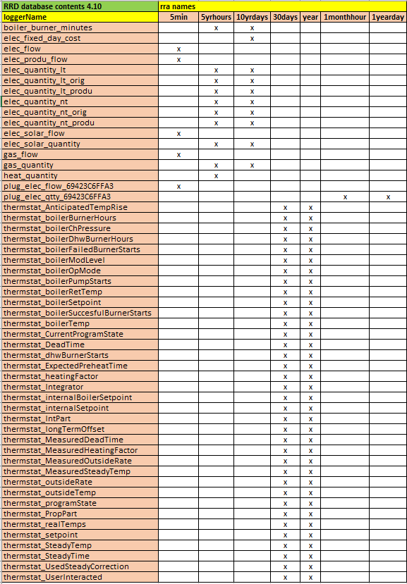

To add to this post for convenience a complete overview of all variables available in the rrd databases from version 4.10.
Note that the ID's after the smart plug variables are different for each smart plug. Each plug will have it's own set of databases.
4_10_rrd_contents_xls.zip
(10.13 KiB) Downloaded 696 times
