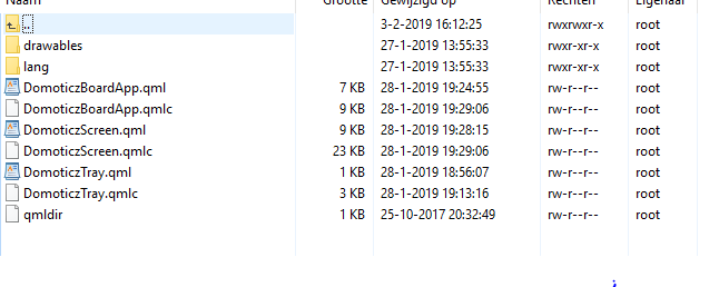

atlantica
Posts: 34
Joined: Fri Mar 02, 2018 10:46 am
Re: Toon app: DomoticzBoard
Post by atlantica »
not that I'm aware off... See the attachment..
Regards
David
